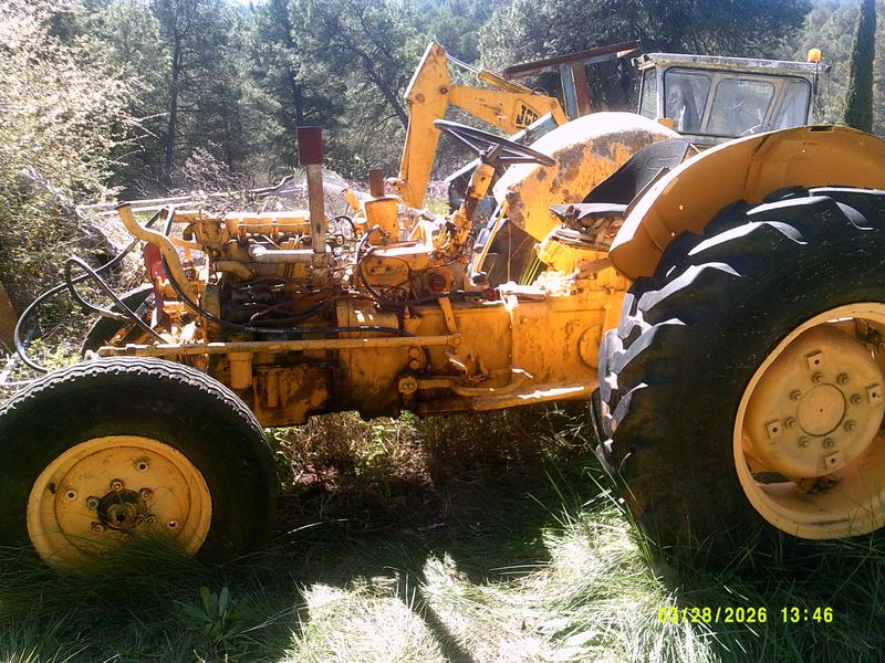

Hi all,
This one is a bit different from others as I know very little about this MF, but hopefully we can sort this out here. I think it's a 205 with a 702 loader, but not sure about this.
As you can see it has a Perkins AD3.152, a torque convertor and what I think is an MF 65 rear axle. The gearbox has two main gears and a high and low lever, with a forward and reverse pedal (total of four gears in either direction).

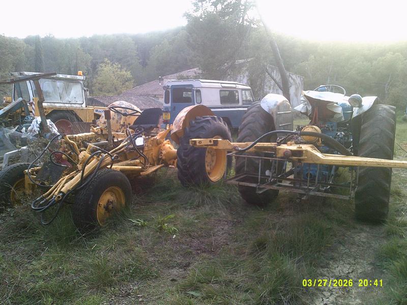

We then got stuck for an odd spanner and other reasons, and never got back on to it. Apart from what you see we only have the fuel tank and fan cowl.
Our plan is to get the injectors out and tested and to see what the inside looks like. There's a good chance the head will have to come off, but hopefully not. Once that's sorted get the engine to run then fix the torque convertor and refit the loader.

Hi Sandy,
I'll need correcting somewhere I expect... In the UK I would recognize that as a 203 (20C with Davis loader) but there's a good chance the numbers are different your side of the water. P3 engine, could be a 3A152 or AD3152 I'm not sure when this changed, 165 back end, 3x2 manual or instant reverser trans., hand lever diff lock. The next incarnation being the MF40 which has self leveling compensation arms and multiplier links between the crowd rams and bucket.
We've had these split many times. When they have a backactor on them you lock the loader at full height and slide the engine etc, straight out the front. Without the backactor we've done it the other way and pulled the axle out the back - 30+ years ago now details may be sketchy.
Weak point to watch for is the pump drive plate on the front pulley. Nasty habit of stripping the lh threads in the plate and loosing the pump drive. Also, forward pressure on the bucket when in the fully dumped position can bend the crowd rams.
Try to keep the brake pedals locked together otherwise if you try to do an emergency stop you will almost always finish up going quickly backwards in an uncontrolled left hand arc as you will invariably by instinct get the lh brake pedal and the reverse pedal at the same time. Don't ask me how I know!

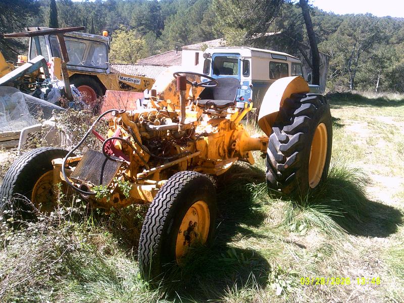

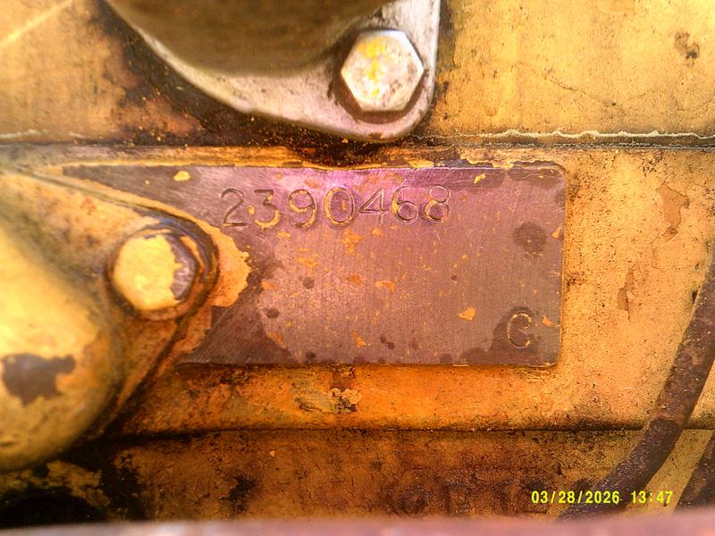

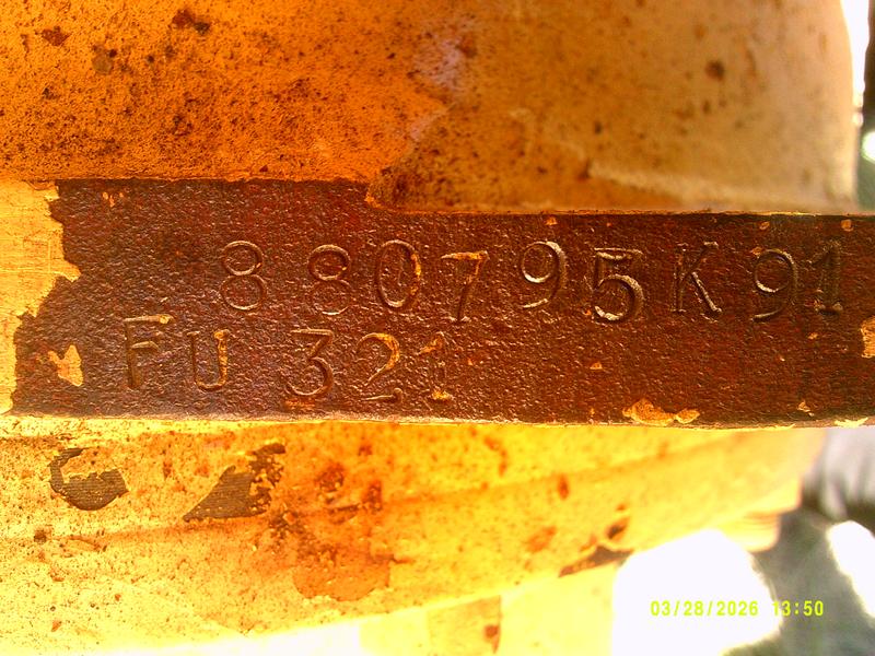

Made limited progress over the last two days, removing the LH frame and the hydraulics. I don't see an easy way without removing the head, still arguing with the injectors. Got the engine and rear axle numbers too.
Super Billy doing the honours. Would have done it with Mr MacGregor but I'm trying to fix the brakes and pedal cross shaft at the moment. Will post about it when we've got anything interesting to show.
frame off
Engine number
Rear axle number
If anyone has manuals for these tractors and their loaders and back actors please send them to Holger. We badly need them here. Would also like to know what the numbers tell about its age.
